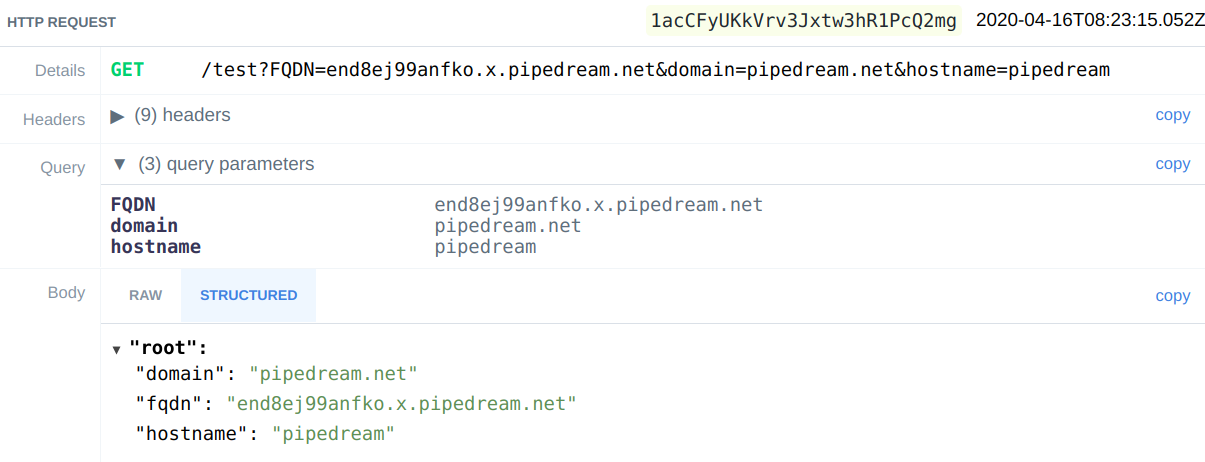

Below is the example showing fingerprint and request generated by it against https://end8ej99anfko.x.pipedream.net
        "vulnerability": "Demo Bug",
        "method": "GET",
        "color": "blue",
        "body": "fqdn=$fqdn&domain=$domain&hostname=$hostname",
        "endpoint": [
            "/test?FQDN=$fqdn&domain=$domain&hostname=$hostname"
        "headers": [
                "FQDN",
                "$fqdn"
                "domain",
                "$domain"
                "hostname",
                "$hostname"
        "checkIn": "responseBody",
        "regexCheck": false,
        "checkFor": ""
incoming request
